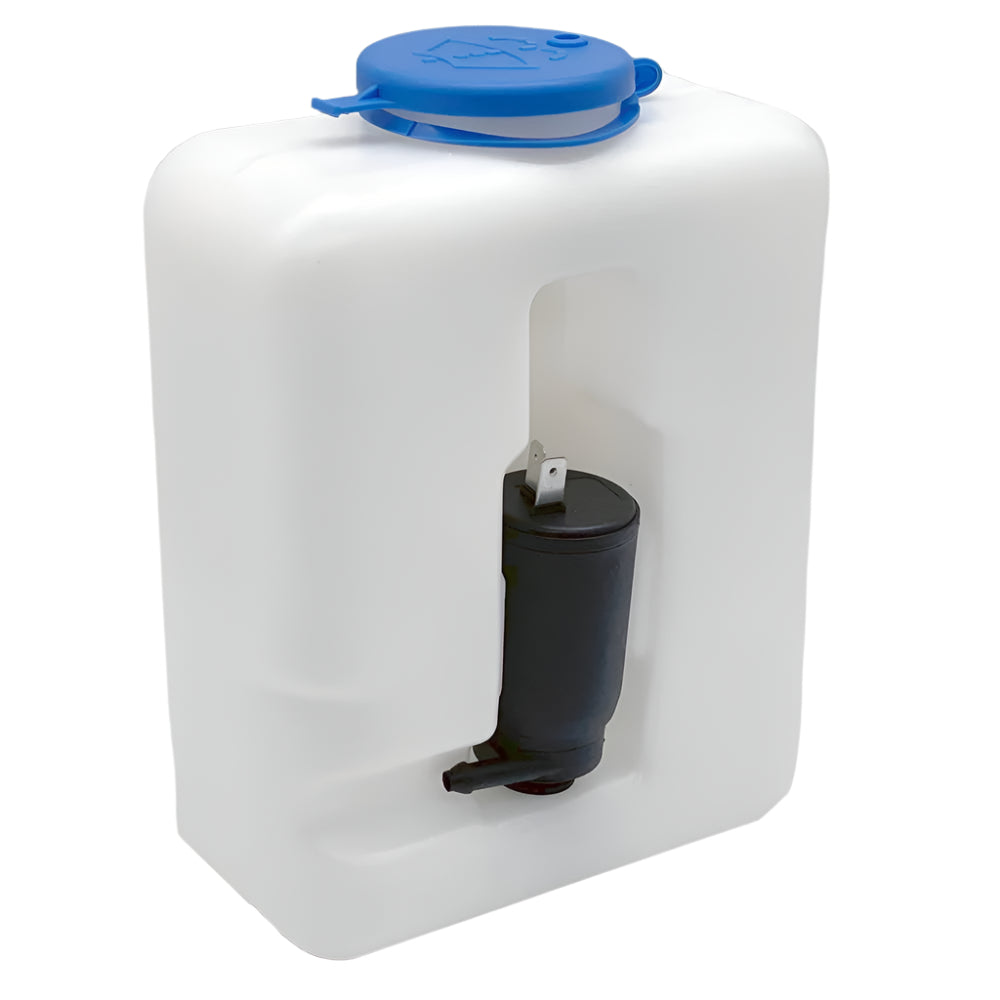

      I have struggled with this cheap **** chinesium now for a few years. The impellor seems to expand when used dry or with water and then binds against the surround ring. This puts the motor under increased load so that it eventually (usually 56 seconds after your sphincter rests) the heat burns through the .0001 micro insulation on the field windings and it shorts out and fails. If you are lucky it will not take safety critical electric circuits with it.
      I tried all sorts, and all costs. they all pack up with boring regularity.
      However new style bottles such as ....
      which accept a far cheaper pump when you buy cheap or don't
        Everything you need. 1.2 Litre capacity nylon bottle with pump and mounting bracket. Supplied complete with two twin nozzles (for up to 5mm thick panels through an 8mm hole, but can be bonded into GRP) 1.8m hose, T piece, push button switch, plated steel mounting bracket, wiring and all fixings. Bottle size approx: Wid
