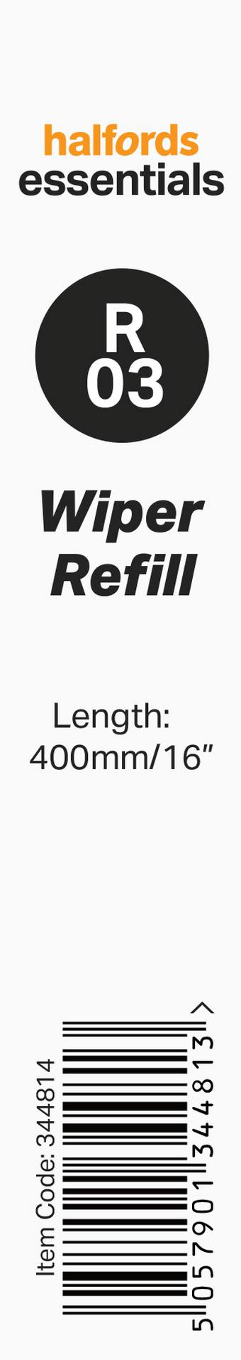

      I re-fitted an older complete blade, but was then advised by a Stag colleague to buy just the rubber inserts from Halfords.
      I eventually did it recently, cut them to length and they’re far, far better - admittedly the blade frames are still old, but they work, the blade feels like rubber and they clear the screen……..hooray!
        These are possibly the ones referred to above. Fitted them to the original Speedblade type of wipers and they work well. Just need to cut them to length.
