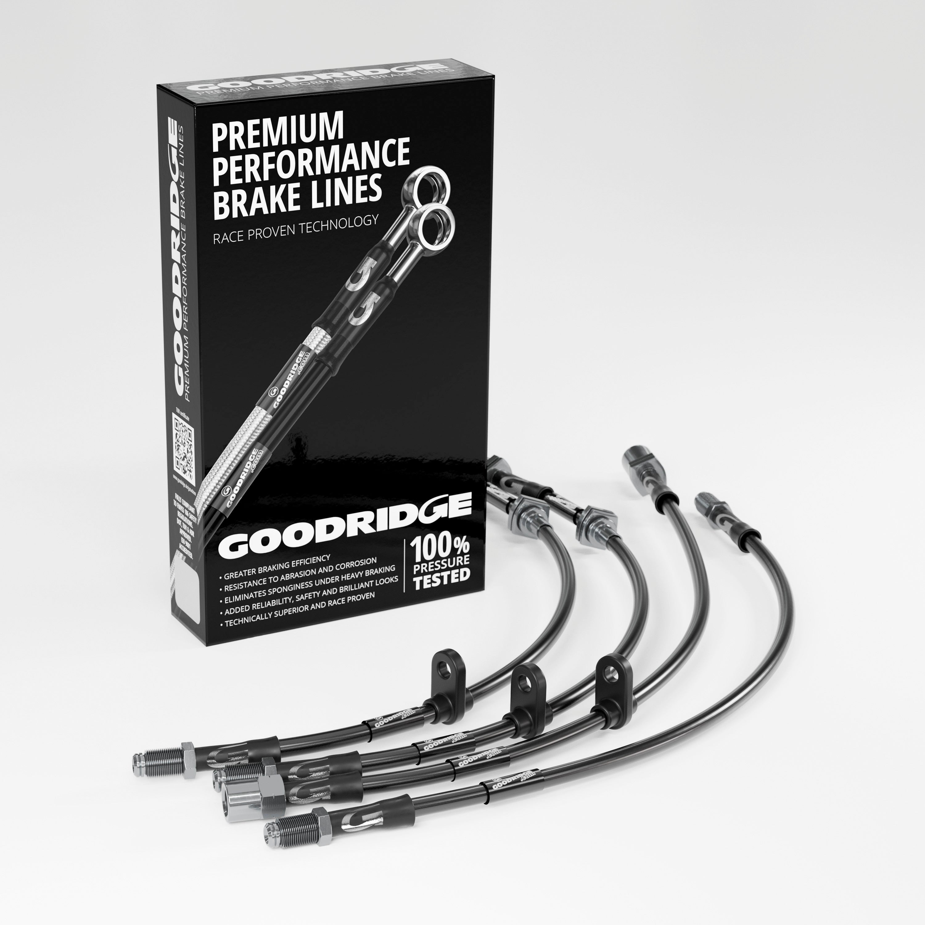

                  Personally I've used Goodrich braided hoses for many years on my Stag - they have the shorter end fittings and copper washers. No problems with brake fade even on really intense competitions......
                    Well it seems that the James Paddocks ones have the conical ends, I can't see (on the Rimmer's website) what the Goodrich ones have on the end as they are covered by red plastic caps.

                      I bought mine advertised as Goodridge but can't recall where I sourced them, possibly eBay.

                          I fitted Goodridge hoses to my first Stag over 20 years ago, no issues. Current Stag came to me over 15 years ago with Goodridge already fitted. Still in place, no leaks.
                          Looking at their website, prices have increased 3-fold since I last bought direct from them:
                          Much cheaper from Robsport:
