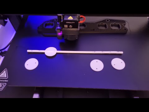

    I am working on a multi throttle body EFi manifold for the left and right banks
    My problem is my heads are away being worked on, and they will be away for several months, and I dont have any heads on my engine to test the fitting of the manifolds I am printing.
    Of course they will be returned once I get the fitment correct
    My printer has been working hard all day on the prototype

          Thanks, but I need physical heads to test fitment, I still have a lot of design to do and physically seeing what I am doing is better than looking at numbers, having said that, numbers are good in the design program.
          Maybe an idea to pop over to you, can bring this manifold for you to have a look at if you are interested. There will be many changes until I have a working model, not happy with the butterflies so looking at designing a spindless butterfly system.

                              I managed to get an accurate schematic of the heads, so working from that, and yes, I have seen some posts about how the gaskets dont line up with the ports, I'm going to go rubber seals in the manifold rather than gaskets, and looking to weld up the waterways, will tap into the core plugs to maintain the water flow.
                              First print of many, after this finished I can see many issues, so going for a complete re-design, but based on the same principles,
                              Good job these prototypes are very cheap to print
