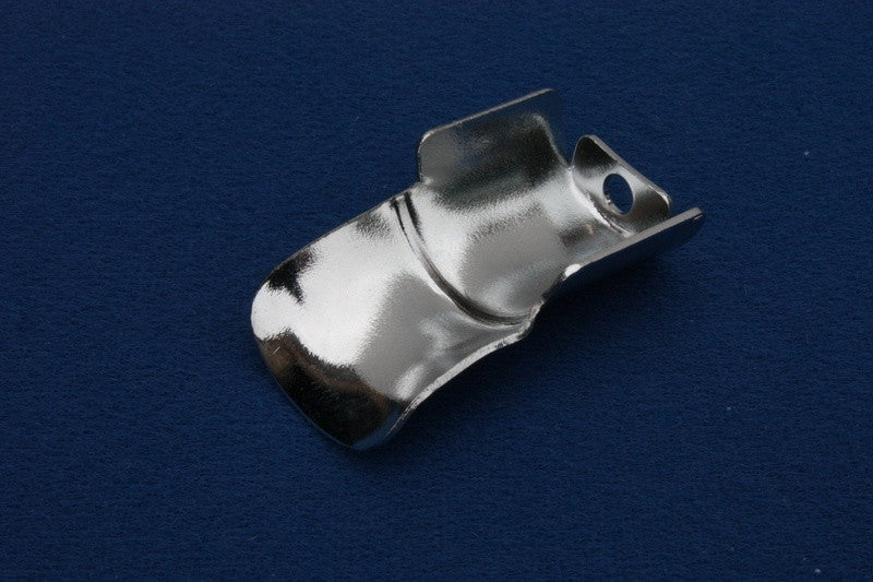

    I also fitted a glovebox pull handle to make it easier to open the glovebox lid for access to my AC parts.

          You say you used a different lock, do you have details?
          Thanks Alan
            Put me down for that info as well, my lock push button worked ok before I decided to refurb the dash varnish. It's now all back together but I have to use the key to drag the lid down 😡
              I looked into this previously, and found this finger pull part 609463 as used on Triumph TR's. Spend hours trying to get the glovebox lid to drop open as it should and eventually gave up - but then installed a different dashboard and the lid opened perfectly first time - no idea why, one of life's great mysteries. So having bought this part mine's now stored in the shed. It's quite widely available and not hard to find using Google, not expensive either. I believe the hole in the glovebox lid may need careful modification, but the finger pull should fit onto the existing latch. I think other people have done this too.
                PS I seem to remember seeing a Stag on YouTube with a finger pull made of a piece of vinyl.
                  Alan. I got a similar lock maybe off another Stag or other Triumph model. The finger pull is found on TR4s I have a YouTube video on one I installed. I did modify it a bit and had to trim a bit of the dash to get it to fit.
                    I used a finger pull from a TR6 (I think), and it was an easy fit, with just minor fettling of the dash hole to allow it to fit snugly between the lock and the wood.
                      Yes that is what I used (TR6 part), just needed to grind some of the glovebox material (at the rear) from around the latching part of the lock to ensure it engages and secures the box lid.

                          Nice one chaps, appreciate the info. It looks like a cheap fix and doesn't look to obtrusive.
                            Finger pull also found in the Herald. As said simple to fit. Makes you wonder why Triumph didn’t fit them as standard.
                              I went one stage further and modified it so is sat further out . easier to grab on to. The alternative is to find a better lock, but I haven't figured out how to take it apart with out damage to match the original glove box key
