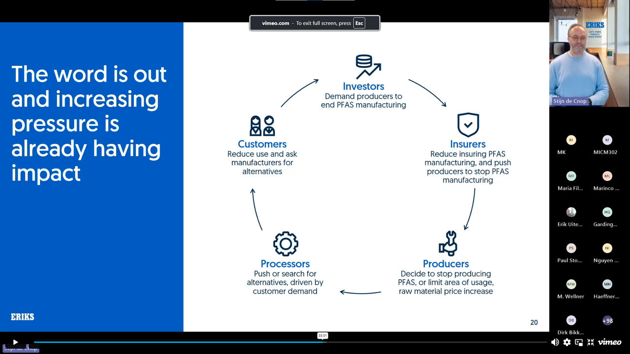

                Viton is a very useful durable polymer…. But it’s about to banned!
                Believe 3m have already stopped production!
                possibly has a reprieve in the U.K. not Europe though.
                Here at ERIKS, we understand that the PFAS topic raises many questions and concerns. That's why we've put together this FAQ to explore the topic.
                There are 2 secrets to staying on top :- 1. Don't give everything away.
                2.
                  Yep, another bunch of good useful materials that will be taken out of "circulation" resulting in a hunt for alternatives that probably won't be as effective. I know there are a lot of valid reasons and a lot do cause serious harm to us (asbestos!) and the environment but the list of banned substances gets longer by the day and affects so many things.
