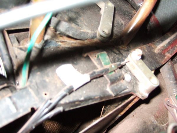

    Hi,
    I cannot find the heater control valve, can someone take a look at the photo and confirm it is not there?
    Thanks
    Hi
    Yep it's gone !!! Weard
      Something doesn't seem right. Attached photo of my Stag heater from driver's foot well. The heater valve can be clearly seen.
        Thanks for the replies, looks like someone has removed the valve rather than fix it, there seems to be some sign of brazing around the inlet pipe.
        I get very little heat from the heater, I was hoping it was the valve at fault, but if there isn't one the flow through the matrix must be permanent, perhapsthe matrix is allclogged up. I tried flushing the heater through and didn't get any sediment or muck coming out though. Looks like a replacement matrix is in order, unless someone knows how to clean it through.
        Thanks

            Dave,
            The enginehad a 74 thermostat but i replaced it with a 88 as the car was running cold. The heater inlet and outlet pipes are quite hot to touch. The flap at the bottom is open, i can see the matrix. Is there another flap? When I set the lever to cold I get cold air, when the lever is set to hot I get slight warm air. What does this lever actually operate, as there is no valve on my heater? Its doing something to change the air temperature.
            I flushed the heater as you described and flushed both ways, flow was good and no sediment came through.
            Most puzzling.
            Thanks
              If the temp regulating lever makes a difference it has to be moving something.The lever moves the cable which would have been attached to the valve that is missing. It shouldnt be too hard to find that cable and see where it finishes up.I must admit that from your photo it looks as if it is still running to where the valve should have been.
              Looking at the picture of your missing valve (?) my initial thought was that someone had done a fairly decent and competent job and perhaps put a valve on elsewhere.It might not be connected to the cable and could be a simple on/off tap.
