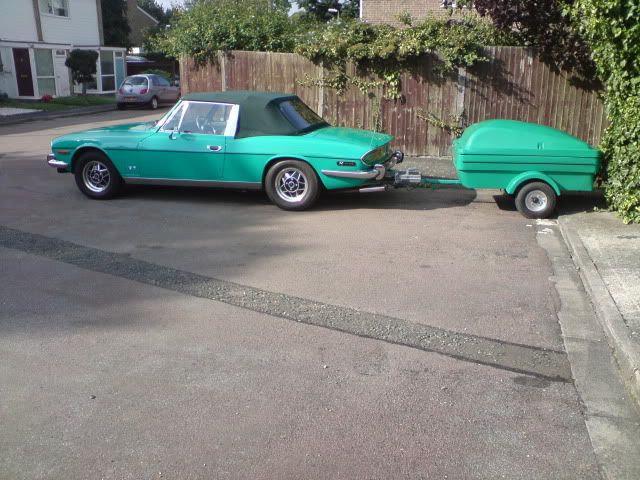

      Mike, are you going to have a Russmobile?
        What's a Russmobile then:?
          The Java Green trailer that Russ has

              I saw a trailer made from the rear end of a Stag once, not that is it?
                no..... it's this abomination......
                Pictured full of my wife's shoes, and general stuff for a family holiday for 4 in Ireland..... it towed the 800 odd miles there and back at 80mph with no problems and the Stag didn't even notice it was there performance wise, returning an average 29mpg....
                Official towing trailer weights are 200kg unbraked, and 1275kg braked

                    Look away now if you are of a sensitive nature . Hope you like the mirrors.

                        I am starting to like Java, do I need help? ;-)
                        Apologies Russ :-)
                          Come back Jeremy Clarkson, all is forgiven ! :P Martin.
