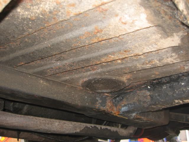

    There is one on ebay at the moment that appears quite solid and, out of interest, I had the guy send me some pics of any rusty areas. These are what he sent ;
    [img][img]
    So on the one above, which cross member is it? Does that look bad? Are those actual cracks in the floor pan?

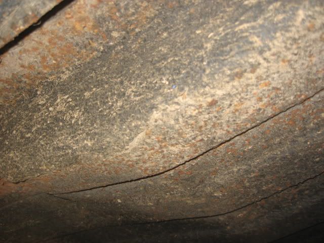

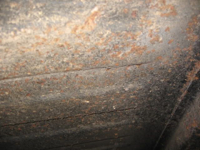

    On the one above and below, are those floor pan cracks? Are they bad enough to require serious work / new pans?

    Your first picture is the drivers side footwell that hashad the outriggerwelded
      i stand to be corrected but im dam sure i see no cracks just the development impressions..............and at a pinch all looks not to bad maybe just need to spend some time cleaning and repainting the underside imho from the pics.....cheers steve
        Looks like oil leak stainage on the exhaust in pic 1.

          The underside looks like mine did when I first got it, that was very solid once i had cleaned all the underseal off.
          A few hours cleaning treating and painting it would be fine looking at those photo's.

            hi guys, thanks for these posts, i learn a lot. the underside of mine is very similar,but without the welding, wards had a look at mine and said it was solid, needs stripping and sealing, they advised me to wax then winter job for the rest

              In fairness the seller said that the underside just needed undersealing and, as I havent been ubder a Stag, I couldn't decide if what looked like cracks actually were just joints.
              Does the outrigger joint look ok or not?

                  Its the other end of the outrigger you need to look at where it meets the inner cill due to crud being sprayed at it off the wheels.

                      As stagdad says it's the other side of the outrigger that is the achilies heal, I'm no expert by any means but ask him for a picture of where it joins into the inner sill.
