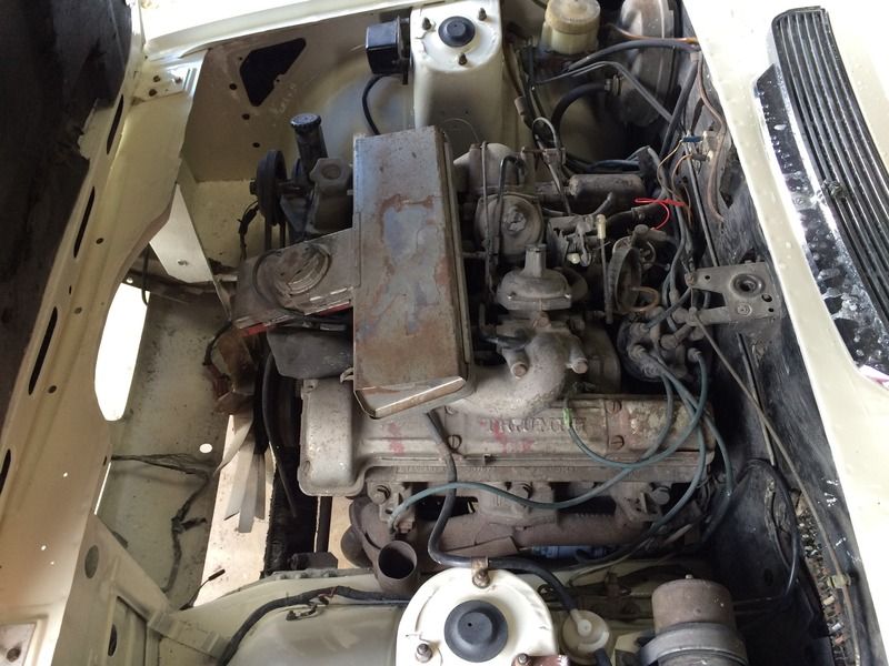

are my carbs likely to need a rebuild?
    cars not been taxed since 1996 been stored in a dry garage
    was contemplating removing to clean out the jets and floats etc but i dont know how reliable they are???
    Have a look at the spindle seals and the seals on the temperature compensators. If they are at all hard, crumbly or missing, it's a good clue as to the general condition. If you find anything amiss, then you need to rebuild the carburetters.
      I would certainly fit new rubber diaphragms as well after 10 years, as they are bound to be perished. Strombergs are reliable things, and when cleaned and properly set up, should give years of service..
      Mike.e
        i noticed the plunger things ontop one had no oil in it

            However, I reckon they (Stromberg's) would benefit from a bit of tlc, Apples.
              So you found something amiss! The 'O' ring on the needle adjuster has perished, so you can be sure all the other rubbers are similarly useless.
              Buy a rebuild kit. Go on, you know you want to.
