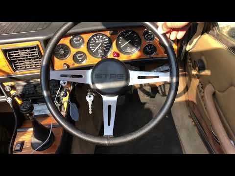

    Just had my front suspension fully refurbished with poly bushes, new track road ends etc and rack checked by reputable Stag specialist but still have play in steering wheel, is this ok? Thought it would have removed the poly to be honest.
    The uj’s in the lower column could be worn so check them but the steering does have what appears to be a certain amount of “slack” when it is moved without the engine running due to the torque rod in the power steering.
