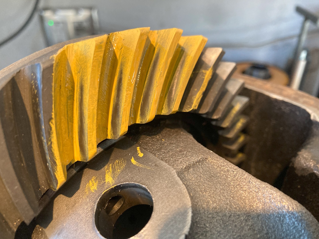

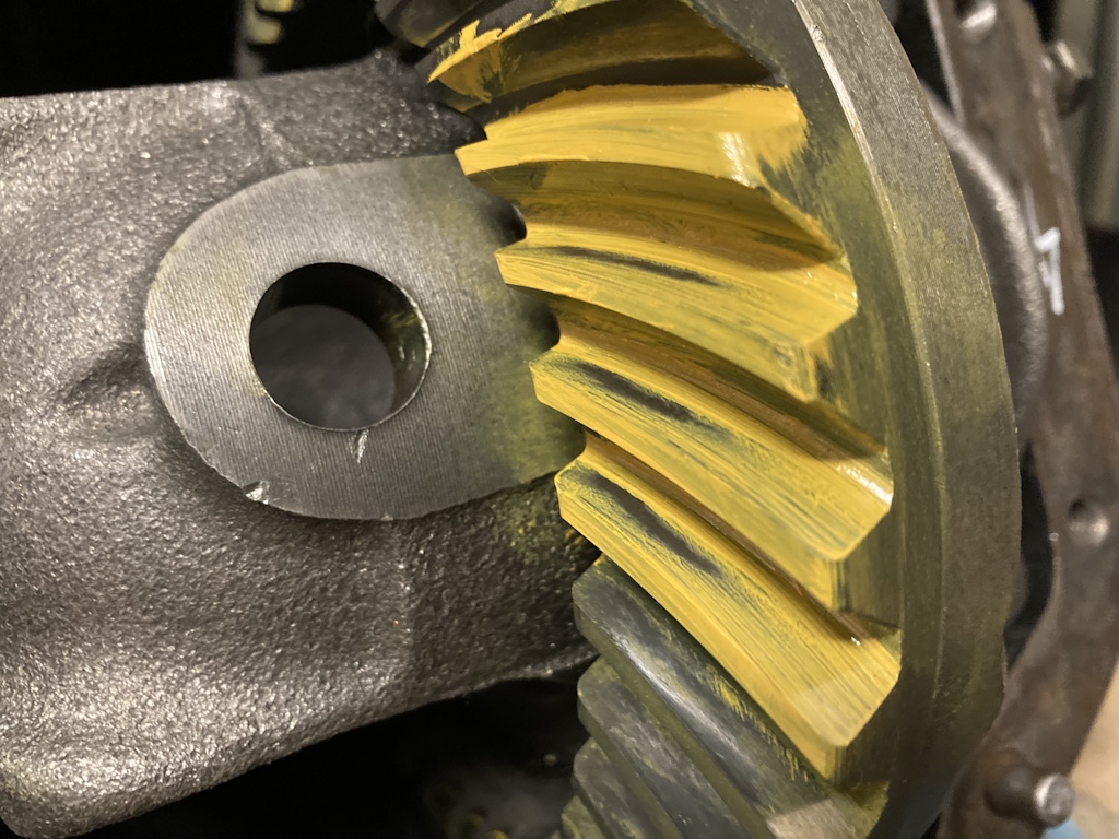

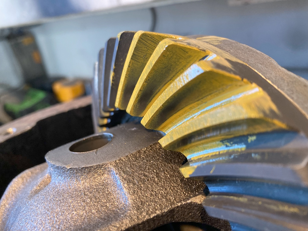

Ready to check the gears.. I thought this video is pretty good at explaining it, Note the tip to put drag on the carrier.
